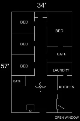

Looking for opinions on the best way to get the heat back to the two furthest bedrooms. With only running the living room ceiling fan, All the rooms get warm except for the far two bedrooms.
They are 4 degrees or so different than the hallway.

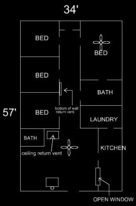

I forgot to draw a ceiling fan in the large bedroom center with the doorway. It's all one floor but you have to step down 6" when you go into the hallway from the livingroom.
