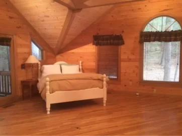

And now the corner I'd like the stove. The bed will be moved to another corner.

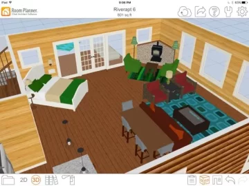

My rendering on a design program.

From corner to trim I have 68" and from floor to bottom of window trim is 52".
