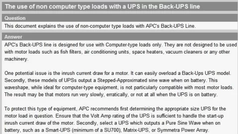

Looked on the internet and it seems that any battery backup that is modified sine wave is fine for electronics
but will not work well for fans and motors.

The "NOMA" unit is a modified sine wave and is not liked by pellet stoves
or most panel tv types. You need a pure sine wave output to do the job

Here is a page off APC's (Major UPS manufacturer) website. It gives a little more insight into the issue of non computer loads with certain UPS designs...
