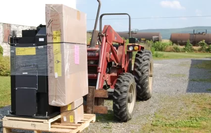

Yippie, my solo 60 arrived on June 26th. As you can see in the background I didn’t have to go very far to find a railroad track.
Ron

I know exactly the plates you mean. I have a few. By the way, is that train behind your loader delivering your storage tanks?
No I think that is his water storage tanks. He only has to fire up the boiler once a month. Ha Ha Or it might be his Oil tanks and if that is the case he need to go to wood. Sorry just couldn't resist.

I wish. I'll have to make at least 2 trips (to Fishers) and thats if I can put one on my pickup and one on a trailer. I do have a full length bed on my truck so I think it will work as long as I can leave the tail gate down and not interfere with the trailer. I'm glad he's only about 45 minutes away.
