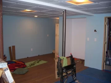

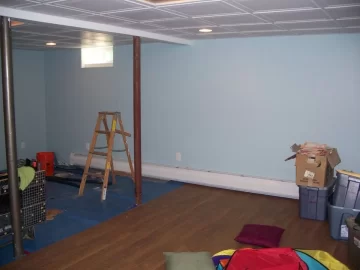

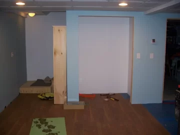

Well, haven't been onthe forum much as I am trying to get the basement done before the kids get out of school. Just wanted to say thanks to many of the folks that responded to my posts about insulation/electrical/plumbing, etc... I learned a lot from many of the kinds posters on the board, so figured I'd post a few pics of my progress. (Please don't give me crap about the color of the walls as I did not have any say in the portion of the reno)
Only have the rest of the flooring to go and then trim work, and then should be good to go.
Thanks Hearth members.

Looks great, Dave. You can come down when you are done and fix my basement, and you can choose the color. Actually, I like the color.==c
Looking really good, Dave. Once you topcoat that baby blue primer with a pleasant color, the place will come together quite nicely. ;lol Rick
Very nice!
I was kidding to my wife that one day she is going to come home and it will be a different color (earthtone perhaps), lol....she was going for the nautical look (greyish blue)...but my eyes only see baby/nursery blue, and although I love my kids to death I don't want to be reminded of pampers and diapers when I retreat to the mancave, lol.

1) What is the light fixture that takes a square in the ceiling grid - some kind of trougher, or whatever it's called? Lol, its not even a light fixture per se. Basically, I had cans installed with recessed ligthing, but I had 2 old basic light fixtures in the basement (bulb and socket basic job) and I'd figure I would keep the light. So, I just got some of those 2 X 2 plexi panels at home depot...and had a few ceiling tiles left over so I just cut a square in the tile that would allow the plexiglass/acrilic sheet to rest on top....not sure if I like it or not, but wanted something in place so that when I just need to grab something in the basement I only needed a few lights to come on
2) Did you just add some baseboard for heat (oil? gas?)? Yes, I added an existing zone to my boiler....oil fired. (Was looking at wood/pellet options, but I wanted simplicity as the room would normally only be used when the kids are home from school and weekends, and ddn't need the heat down there for 10/12 hours a day. Don't like paying the oil man, but in my case it really was the best option. For the zone, I ran 16 ft of high output baseboard that puts out more heat than a normal baseboard. I used pex from the boiler to the baseboard, and then the rest is copper.I did have a a tech come in as I needed some other stuff replaced on my boiler, so along with the boiler items I had replaced I got it done for $1300 which I think is reasonable with all the work he did on the boiler.
