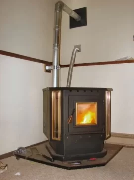

I have a basement install with an Englander 25PDV. I'm having great luck heating my 1800 sf raised ranch. Downstairs(finished) temp is around 78-80, upstairs 72-74 in living space, 68 in the bedrooms. I also cut a couple holes in the floor and installed two booster fans that really seem to move the heat around. http://www.atrendyhome.com/durebofan.html I turn the stove down to 1 or 2 during the day when everyone's at work and school, then turn it up for a couple hours to get the chill off. Going through about 1 bag of pellets a day doing this. I'm saving so much money and soooo much warmer then I was with the electric baseboard heat.

Good for you. This being installed in a "finished" basement is the key.
