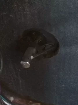

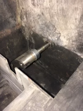

This older Magnum 3502 multi-Fuel Pellet Stove has had some good use and the fuel stirrer rod was banging and then stopped working. The lower sprocket set screws were loose but the bronze bearings were really worn and dirty inside.

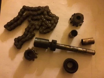

The chain and sprockets were also worn so time to replace using the Fuel Stirrer repair kit.
The Fuel Stirrer Repair Kit comes with a nice bearing removal tool that makes it easier!
Pic 1 - Fuel Stirrer worn out parts.

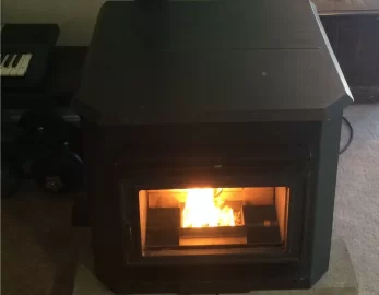

Pic 2 - Fuel Stirrer Kit all new parts installed.

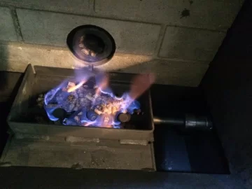

Pic 3 - Removing top sprocket with claw hammer, it was stuck.

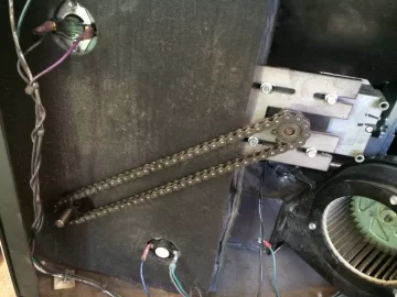

Pic 4 - After old bushings were pounded out, the new bushings are pounded in one after another!

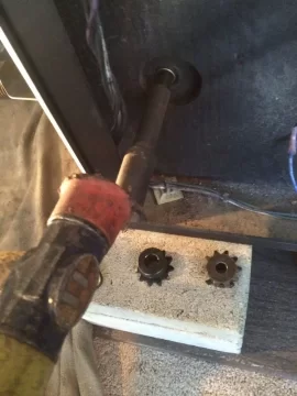

Pic 5 - Fuel Rod and new locking ring.

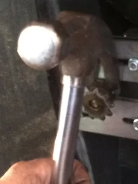

Pic 6 - Tightening down new sprocket 2 set screws.
Pic 7 - Fuel rod now turns like butter!

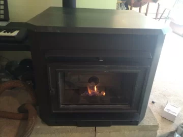

Pic 8 - Stove is starting!
