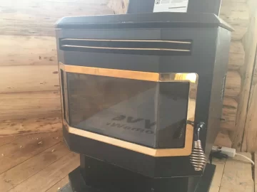

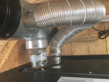

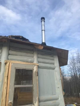

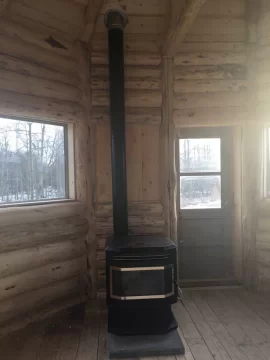

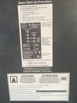

Thanks Bob! Here are some pics...
This is in a 16x16 log cabin (320 sq ft).

That first picture! Is the fresh air hooked to the vent pipe? How does it get outside air? That should go through the wall and draw from outside the cabin. Thats why you have no heat. No air no burn. Detatch that and leave it unhooked and run the stove. If it burns better hook up a new oak through the wall
Ok i have done some homework to educate myself. That is a Selkirk direct-vent pipe it draws its fresh air from the outer area of the vent pipe. Only thing i can ask is the top of the pipe open to get air into the outside wall of the vent?

Nice install.I see a cold cabin,with the poor door and windows,but that stove should kick out enough heat.Read the manual,go through all the settings,make sure you can make adjustments,there is also an accutron 2 test page on the net,somewhere,do not have it handy.
Show us a picture of the flame on the highest setting. Should be quite large and lively based on my Pelpro ecperience.

Are you sure there is a difference in heat setting 1 to 5? As I recall setting on setting 1. The auger light comes on for 3 seconds, and off for approximately 10 seconds. On setting 5, auger is on for 3 seconds and off for about 5 seconds. These settings are adjustable for feed rate by turning the low or high screws on control board. Recommend reading manual to do this correctly.
How long is that run total? Might be that it is too long for the OAK to be effective. I think it is supposed to be no longer than 10, maybe 15 feet. Try disconnecting the oak at the stove and see if that helps.
