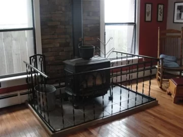

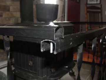

sullystull said:I just posted these pics today in another thread. Save your $$$$. I bought sections of railing from Home depot and constructed this--works great and for less than $50.
joecool85 said:sullystull said:I just posted these pics today in another thread. Save your $$$$. I bought sections of railing from Home depot and constructed this--works great and for less than $50.
That's beautiful, what'd you do for hinges or is one section removable to get to the stove?
