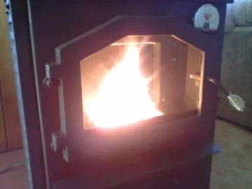

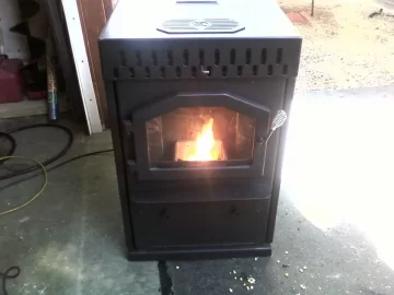

My buddy (Forum member barnyard840x) and Forum member CWR have them. My buddy bought his Brand new last year, but it was made in 08 or later (Cant remember exactly). Its a good little stove and does a great job at heating his place (Prob in the nieghborhood of 1,000-1,100 sq ft) on heat setting 2 out of 5. There are a few things that he has done to achieve a better burn. Within 24 hrs he had to "Dump" pellets out of the burn pot because it would overflow. That was with the Damper opened all the way... It does not get enough air through the burn pot. Now after his little mod, it can go for days or weeks. He made several holes in the bottom of the pot larger and closed up the top 1 or 2 rows in the burn pot. Now all the air that used to come through the top 2 rows, is pushed in through the lower/larger holes (Where the pellets are burning and NEED the air) and the flame is highly active, ash is light grey to white instead of the sooty black poor burn it had before the mod... Now he can utilize the damper to control the air/burn. (In No way shape or form recommend ALTERING a stove. I am shareing results. Please use caution doing any Mod on your stove. This may/will void any warranty)
The next thing he is doing is adding a gasket or getting the burnpot to seal better. It has a very poor fit and has leaks around the corners, these leaks, if fixed, would divert even more air past the pellets. The gaskets were mediocre at best. Replaced the Hopper gasket and ash pan gasket.
BUT, after all that, it is a fantastic little stove. Has many heat exchange tubes to exstract as much heat as possible (18 I believe) Also the Low #1 setting can be adjusted, so when its on a thermostat it can go down to a "pilot" light. Feeding just enough pellets to keep a fire going until the call for heat is needed again. He is not as much a Pellet Guru as me. I talked him into the pellet stove, and he loves the cheap heat. Hopefully his 2nd year, the bug will bite harder.
