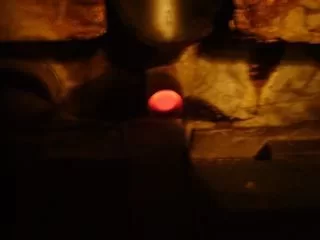

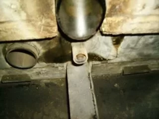

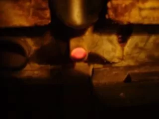

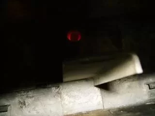

Avalon 900 PS stove. Went to fire up for first fire of season and pot overfilled. Igniter comes on but doesn't light pellets. Cleaned stove, exhaust box, flue trap. Still will not light. As I remember from last year, the ignitor was clearly visible in the fire box when starting. I can see it is on but does not seem to be shooting into the fire box. Pellets will not even char. I've attached some picts of the ignitor. First is with the flash on, rest is without flash. Does it appear to be working right? Glowing as bright as it should?
Question- I would think that the igniter would either be good or bad, not partially bad. Am I on the right track?

any stick heater that glows like that will have the insulation breakdown and fail eventually........too me a poor design, but I would think a pellet touching that should ignite....is air suppossed to flow around the stick heater and ignite the pellets?
I'm very, very, unfamilliar with your stove
The end of the igniter doesn't stick into the burnpot. It sits about 1/4" away and the burn pot has a small hole (3/16" ?) that is aligned with the igniter.
I have a Lopi Yankee also made by Travis, and that seems like the same as mine. The igniter sits just outside the burn pot and glows similar to yours. What about the draft setting? Didi you try opening it more or less?
Looks just like my Astoria when it gets hot....I would think that's hot enough to light pellets.
BTW, are the pellets new and/or dry?
Looks plenty hot enough for sure. Is it possible that the
ignitor got pushed back while cleaning and now it's not reaching
the pellets?
stove is working fine after a manual light so I believe I can rule out air leaks, clogs, etc. and that my problem is the igniter. Zeta- I'll check for movement but I doubt that it could move. The igniter is recessed in a steel sheath. This is consistent with a diagram in my manual.
MacMan is the end of the igniter spaced a little away from the firebox on your stove? From memory, last year it seemed as though igniter would shoot into the firebox.
