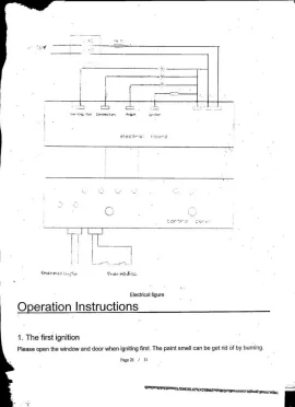

Not familiar with that model or brand. However it sounds like stove thinks fire went out so not feeding more pellets. Usually a snap disk has to be heated up enough during initial fire starting in order to continue auger operation. If you have a manual or schematic to reference that would help. Typically this snap disk is near the exhaust blower.

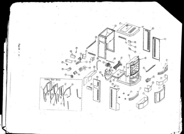

Thank you so much for responding. I'm stuck and really appreciate your help. I will try the dollar bill test and clean the entire flu. the combustion fan seems to blow well as well as the exhaust fan. I drew on the vacuum switch for about 10 sec. Not sure if that was long enough. I have included a the only diagrams I have. Not sure if they will help. The snap discs are number 18 and 20. Thanks
