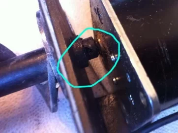

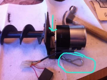

My auger isn't really rotating fully all the way, been noticing the slowing of the rotation. It also starts, feeds pellets for the starter ignition but then it does not keep the pellet stove feeding afterwards. I have cleaned out everything (firepot, auger, pellet hopper, vaccum switch, plates) and noticed that the cotter pin broke, went to the store and found a replacement.
Now here is the question, is there a trick to getting this thing in? I been trying to put where the arrow points but I am unsure if there is something specific I should be using. Also when I put it in, does the cotter pin just go straight through with nothing else to do? I haven't found any website useful in this area.
Is that connection between the motor and the auger suppose to be that greasy?

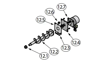

1. Look at the manual diagram and compare it to your pics. It looks like the plates are against the auger motor and the feed motor hitch pin goes to the outside of the plates. Could be just a bad image in the manual but then again. A pair of needle-nose pliers should do the trick. Yes it just sticks in the hole and locks half way through.
2. I would clean that auger pretty good there appears to be a build up of fines. Some of them may have gotten inside the housing and may cause you issues. Have you tried running the auger while out of the stove to see if it rotates without impingement? Also check for an oil port on the motor. May explain why it looks "greasy".
3. Make sure you find all the broken parts of that feed motor hitch pin. They can really jam things up if not removed.
4. Look over the auger and the area around the auger to make sure the broken pin did not bur up an area causing not to spin without hanging up.
5. The feed could be unrelated to the broken pin and auger. Make sure the hopper switch is working and the lid is closed. Also did you clean out the venting as well? I did not see that mentioned in your post.

Thank you so much for your help.
The old cotter pin was really jammed in there and broke, was able to break it all out and get the new cotter pin in.
I cleaned the auger even better, got rid of a lot of the fines.
The oil port on the motor, I did not check.
I ended up putting the auger back in and giving it a start and everything is working fine at the moment.
