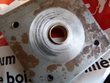

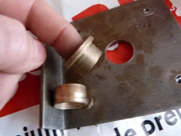

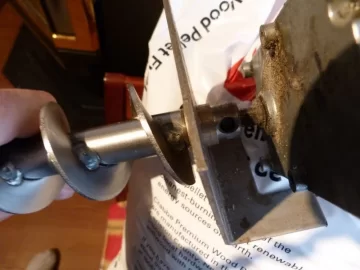

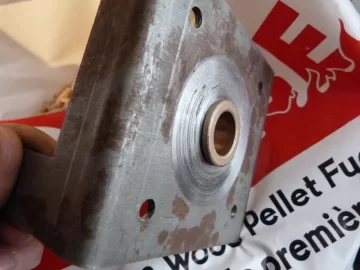

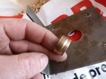

Hey Guys, just got the new Bushing today to put in my Auger, took about 15 mins total, pretty painless job,she's alot quieter now for the price of $.98 cents. As you can see in the pics, the old Bushing was worn so bad, it didn,t even have the flange left on it. Original Bushing was $20 from Enviro, this one was 1/8 too long for $.98 cents, cut it down easily with Hack saw .Hope the pics will help someone else..
