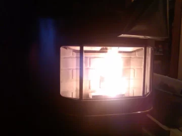

The Low flame sympton came back again on the Astoria.

The Auger duration is not the full 3 seconds so the burn pot is low on pellets.
There are enough pellets so it runs but not enough for the good long flame.
