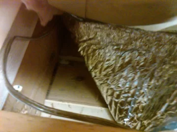

So I pulled up the all the floor boards and added 2x2s to the 2x4s to make 2x6s. Pulled out all the old insualtion. Rolled down the foil which also makes a good vapor barrier! Then I added in the R19 6" Fiberglass insulation and screwed the floor boards back instead of nailing them!
As far as the air handler goes, it was high enough off the floor to get the 2x2s added to the 2x4s and put in the foil and insulation. Then the drip pan just fit nicely on top of the newly raised floor!
See pic on first completed floor section below: ( I did 3 floor sections at a time)

Thanks, it was alot of work but worth it. The boards can be unscrewed and the insulation picked up like a tent to work on the fixtures or wiring. That works well.

So in my case adding the polypropylene encased reflectix foil under the attic floor insulation acts as the vapor barrier. It is a building code so I believe it works!
See foil in link below
