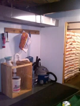

DexterDay said:Get a Good Shop Vac and use a "HEPA" Filter and a Fine Filtration bag on the inside. Will filter the Dust/Ash better than your average Ash Vac and also cost less. No matter what, you can not suck up HOT Ash with any Ash Vac out there. they all say to cool down before using.

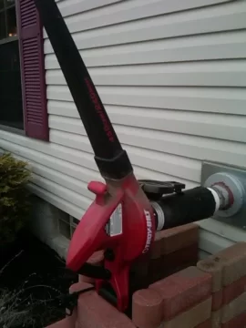

This is the one I have in the basement for my "Pellet Sifter", but the one upstairs is the same. Also spend $40 on a Good Leaf-Blower for cleaning. My troy Bilt was About $40 and a $2 piece of 4" to 3" PVC makes it hook right up to my Vent. Put a little tape on it, so I dont have to hold it...

Still needs a good full cleaning and a brush ran through the vent. Do the leafblower after everything else is done. Or if you can get someone or something to hold the leFblower. I run it the whole time I clean.oldmountvernon said:DexterDay said:Get a Good Shop Vac and use a "HEPA" Filter and a Fine Filtration bag on the inside. Will filter the Dust/Ash better than your average Ash Vac and also cost less. No matter what, you can not suck up HOT Ash with any Ash Vac out there. they all say to cool down before using.

i finally see the leaf blower trick in action, how much cleaning do you do prior to the leaf blower ? or does the leaf blower do it all?
DexterDay said:I forget the name, but Menards here in Ohio had an Ash vac for like $50-$60. My buddy the has a CB 1200 like mine, Loves it. I still opted for the Shop-Vac. The stove should be cool no matter what vac you use. Even a Cheetah has to have a cool stove (Warm I believe is what they say). I have my choice of Filters and Bags (Fine Bags and HEPA Filter). No Dust/Ash in my house or my basement were the pellet sifter is... Only takes about a ton to almost Fill the bag of a 16 Gallon/6.5 HP Shop Vac, while sifting. No dust upstairs or downstairs. Granted the money I spent on a Vac that size, along with the HEPA Filter ($35) and the Filtration bags for the Inside, I could has bought a Good Ash Vac. But NO Ash Vac will Suck like a 6.5 HP Shop Vac. Before buying my Leaf-Blower, I hooked one up outside and sucked. It worked almost as well as my 450 CFM and 240 MPH Leaf-Blower.
Ash Vac have there place in the market. Shop Vacs do also. Some people need the reassurance of the "Steel" can. But like j-takeman said, the still have a filter that can smolder. So to each there own. We all have different stoves, different homes, different cars, and different jobs. everyone can be a little bias. Buy what you want and buy what you like. Just remember to practice responsible habits/behaviors when performing any maintenance/cleaning of any stove that contains a Fire.

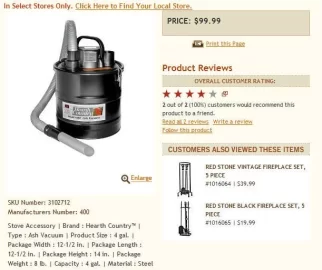

Don2222 said:Hello
Hearth and Country makes a more affordable one. Looks like TSCs price is cheaper than Amazon!
http://www.tractorsupply.com/heatin...-country-trade-ash-vacuum-800w-4-gal--3102712
It is cheaper then these on Amazon
