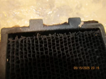

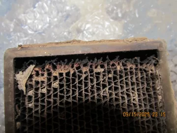

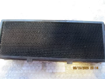

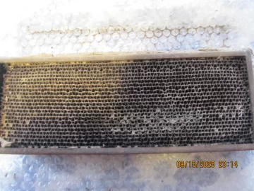

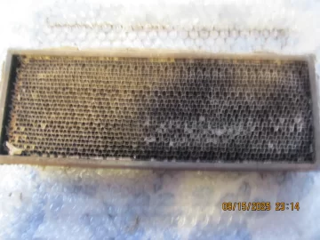

I replaced my Cat today this is a Metal Monolith cat it has been in my Princess since September of 2022. It has 17,280 +/- hours on it. I replaced it with another one. You can see the front in the first photo, the back in the next 3 photos and the front again in the last. In the last two photos you can see that it has pulled away from one edge a bit I'm guessing that is why it was taking longer to get active. But all in all, not too shabby, I guess. You can see in the second and third photo's that there were some blocked up cells on the back of the cat.

I’m assuming it wasn’t going active as fast anymore as the coating on the cat was probably used up with that many hours on it.
I would guess so I did the numbers a few times and, yea lots of hours. A few moments ago, I finished up sawing and stacking 2028's firewood up in to stove lengths now to split and stack it at some point.
