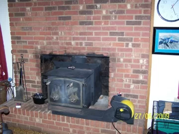

I have a fisher insert and it seems to do just fine without any blower. But i do have a homemade blower i sit in front to blow through the circulator box. Not sure if you get any more heat or if youre just stirring air. A little hot air or a lot of warm air.
  • [Hearth.com] Are there any inserts that are effective without using a fan?

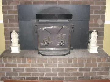

We use our Fisher insert with this home made setup. As you can see, it's a big fan and if we run it slow it doesn't make any noise at all. I was conserned that the big fan would take too much heat from the stove and cause creosote problems but we found this is not a problem. You can also see where I welded a pipe on for the stainless liner. It also has insolation and top and bottom bloc off plates. We turned a dangerous slammer insert into a safe efficiant free standing stove. The stove looks much better with the surround off. It does a real good job of heating now with no drafting problems. A stove is much better than a insert.
