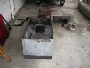

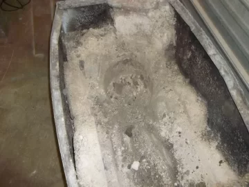

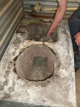

The old refractory base, all 1,400 lbs of it. Other than the tunnel, it was still in fairly good shape.
[Hearth.com] Aquastat Well question

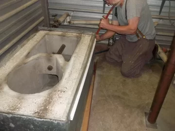

Took several hours with a sledge hammer to break it up!

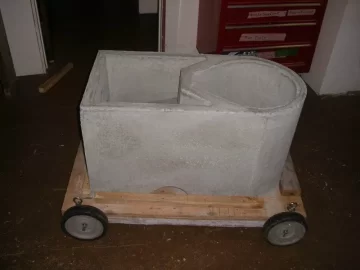

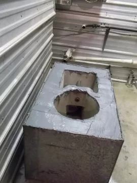

The new refractory base.
The gasket between the base and heat exchanger is 3/4 inch of high temp stove cement (2,700 F)

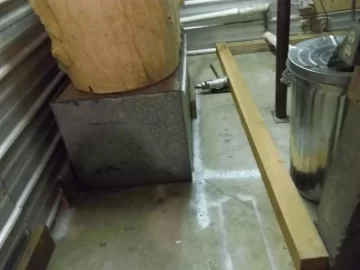

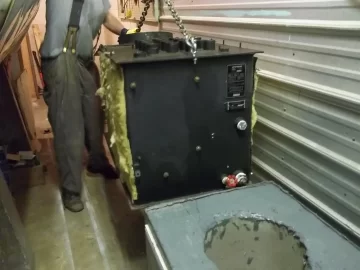

New heat exchanger being moved into position.
The heat exchanger installed on the base didn't quite line up with the chimney so it had to be moved an inch.

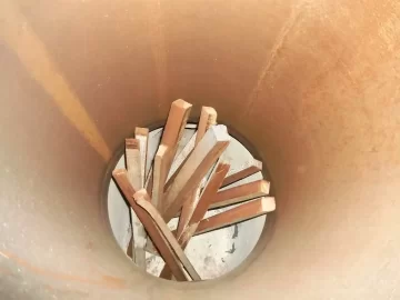

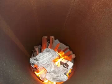

Ready for the first fire.

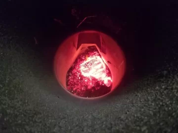

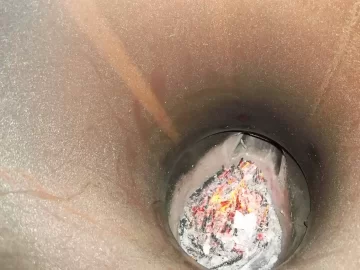

First fire!
It takes many of these small fires of burning 3lbs of wood every 2 hours to slowly cure the refractory. The black ring is an indication of being uncured so the soot can still cling to the refractory.

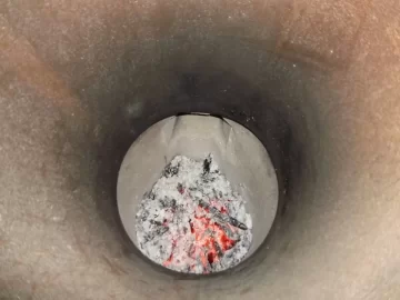

It took 29 or 58 hours of small burns to drive all the moisture from the refractory. The black soot line is gone.
End of the first 6 hour batch burn. The line of one small stress crack is visible on the right hand side of the burn chamber.

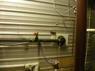

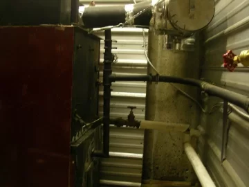

I have remotely mounted the blower and have piped the air to the boiler. The blower gets its air from a duct that brings outside air down into the basement. What I'm finding is that not all vacuum cleaner motors are equal units. Even with the same part numbers they sometimes deliver too much air so I have included a gate valve to dump air if the fire is getting too hot. Also this small amount of excess air into the boiler room has eliminated some of the fine fly ash into the boiler room.
The hour meter lets me know when it's time to change the motor brushes. With this setup, motors go through about 3 sets of brushes and are lasting around 1,800 hours!
