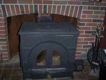

Top cat practically a neighbor can you provide a picture of your current setup tell us a little about venting these modern stoves draft different than your old one
here is a pic of the stove(b-4 the doors broke off) as you can see it goes right into the fireplace and up the chimney.as far as venting that's all i know it goes up the chimney. thanks

Hrmmm, doors broke off eh? Can you describe what happened?
