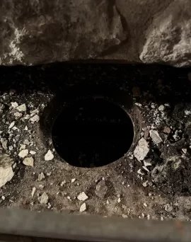

I have an Appalachian 32-BW in my basement I just purchase. It does not have a liner in it. Looks like a 8” opening.
I have a 6” liner kit, can I put a 8” in the stove opening that converts to a 6” that I could connect to the chimney liner? Like a 8”-6” reducer ?

It doesn't look like there's room for a reducer and it's uncertain how well it would work. Appalachian's docs are not the best and avoid discussing flue size. Be sure to have the chimney completely cleaned before putting in a liner.

It’s an 8 inch opening on the stove. are you saying I don’t have enough height to put a reducer? What would be the best way to put the liner in? Just purchased an 8 inch liner?

On the reducer for the liner. see attached photos. i'm thinking if i put the 8" piece in the stove and connect the 6" piece to the chimney liner I have, this should work...?? Any other ideas? Thinking of getting something like the attached item reducer.

The reducer is the opposite of what is needed. The crimp needs to be on the stove end and the 6" side need to be large enough for the liner to fit into it. This will prevent creosote from dripping on top of the stove.
