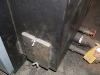

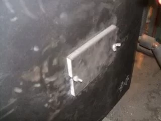

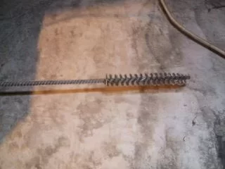

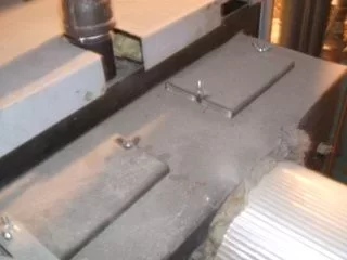

I purchased my Dakon boiler from Zenon 4 years ago, and I drove about 4 hours to see it in action. I suspect that the Attack boiler is similar to mine in that the rear of the boiler has a combustion gas collector which sucks hot exhaust gases over rectangular fins that are welded to the back of the boiler body. There are probably access panels on the top, back and bottom sides of this combustion collector that you have to remove in order to manually clean. I clean mine with a boiler brush about every month and vacuum out the ash. I've hope these enclosed pictures help..

Thanks for the photos Bob. That does shed some light on things for me.
