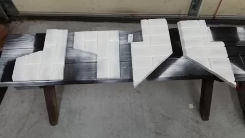

I plan on painting my brick inserts, just picked up some VHT Flame Proof paint, white primer, red, and black to do a misting effect.
Will also paint the heat exchanger cover panels.

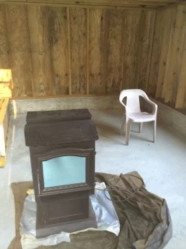

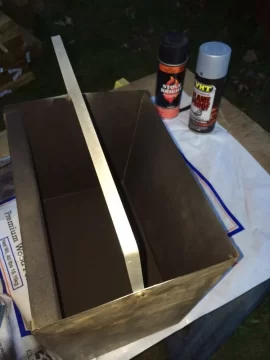

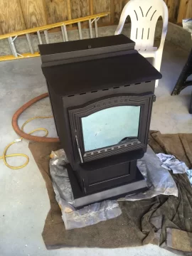

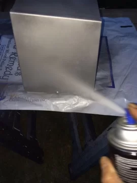

I just painted dis Harman P-68 in da new verkshop! It has a partial roof and no doors or windows yet, so it is very well ventilated. LOL

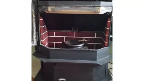

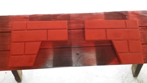

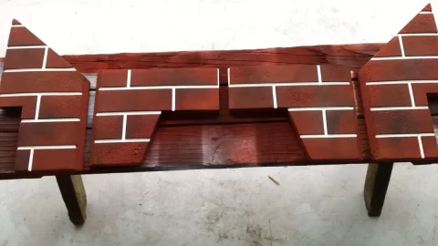

Just finished doing my brick inserts.
Anyone painting their stoves this summer? Anyone painting their stoves this summer? Anyone painting their stoves this summer? Anyone painting their stoves this summer?
Got the idea from smwilliamson!!
Nice little tedious project. LOL! Looks good!
Actually wasn't that bad, had 1/4" fine line tape that worked perfect. Here they are back in the stove...

Very very nice!

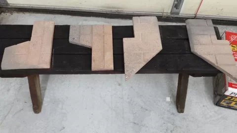

What are the fire brick panels made out of? Do they take the paint ok?
Thank you. I believe they are ceramic, they seemed to take paint just fine. I used the vht 1300-2000 degree automotive paint, and then cured them in a oven i use for powder coating.
