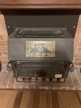

I have a wood stove insert in a brick chimney on basement level. It does not have a liner and I am curious if anyone has any experience with these.
Anyone know what kind of wood stove insert this is Anyone know what kind of wood stove insert this is
Black Pine stoves were made in Prince George in the early 80s. Attached is an ad for the stove line.

If you are going to spend the money on a liner spend a little more and get a modern insert.
