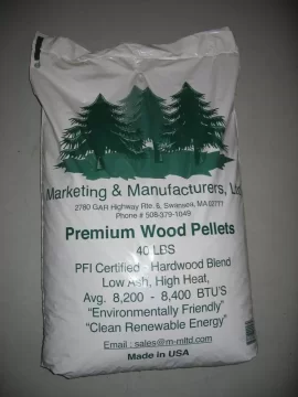

Anyone hear of Marketing & Manufacturing Hardwood Blend pellets?
I have them but haven't burned them yet. Supplier told me they were Maine Woods packaged by M and M ltd..

Gave two bags to my brother-in-law, they clogged up his auger. Brand new Lopi Leyden.
I opened a bag and they look like crap, all broken up, dust, small crap etc... Opened a 2nd, same thing. This is not looking good, I have 3 tons of these. Maybe I can sift them.
More than likely your problem was caused by bad storage. This can happen at the mill, distributor, retailer, and/or when they got to your house. Pellets have to be stored indoors no matter how well they are wrapped. Moisture breaks down the density of pellets. That will cause the auger to jam and in an extreme case a hopper fire.

Not moisture or storage. This is a brand new plant just online. Mine traveled 40 miles shrink wrapped and were all broken up. Even the longer ones just crumble when you touch them. Having said that.... I burned a bag of Summers heat from Walmart just to try. They were uniform and solid but were much dirtier than the Maine woods. Clinkers everywhere and dirty glass. So as I said in another thread, as long as they burn clean and well, can't worry too much about the size.
Mine are burning, though not clean. Tons of ash and firepot getting buildup after 6 hours or so. I'm sifting them a bit first with a 5 gal plastic bucket that i drilled a bunch of holes in bottom. But they just break up when I shake them too hard. Whatever, I have them and that's my fault. Chalk it up to newbie ignorance and move forward. Next year I'll get something like Lignetics.
Yeah I'm burning them now. Until the hopper is empty of the Lignetics I had in there it won't be 100% Maine Woods pellets, but I mixed the two as best I could in the hooper with my hands.
These ( Maine Woods ) definitly burn hotter than the Lignetics. I can feel the hotter air and there's no doubt about it.
Lots more fly-ash and the pellets are smaller, some very small.
I'm a newbie but all this evidence tells me these are soft(er) wood pellets.
They break up easier and burn hotter.
No problems so far so I'll go throught my 1 ton of Maine Wooeds and then get beck to burning my 2 tons of Lignetics.

Are all the Maine Woods packaged in the M and M Ltd. white bags??
Was wondering if there's a different batch of these coming direct from the factory.

I burned these last night and they did burn ok but they produced a lot of fly-ash and a lot more ash in the pan this morning.
My stove ( Big E ) had no problem feeding them, no auger troubles, but because they are small they did bounce around and some bounced out of the burnpot once they hit it. Much more so than the Lignetics did.
They are smaller ( some like kernels ) and softer than Lignetics.
I did notice it seemed they produced more heat.

nope, I bought 3 tons from Dysarts in Bangor Maine and dont think they are packaged in M and M Ltd bags. It has been a while, but I think they do say Maine Woods and have Athens Maine on the bag

Buyer beware. If you can find other brands buy them. These are the worst I have ever purchased and I am not new to this game.
As a follow up. These have clogged up my auger twice already (both yesterday). The second time was around 1AM last night, I just happened to wake up to check stove. It took a good 2 hours total time to unclear all the crap that got packed up into the auger assembly. These burn horribly dirty and low heat also.
I contacted the dealer and he will be accepting these back from me for a refund (minus 5 bags that got burnt or wasted). He would offer a swap to something like Lignetics but he doesn't have anything in stock right now. Will use 3-4 pickups to bring them back and re-stack in his warehouse. He said he'll return them as well.
