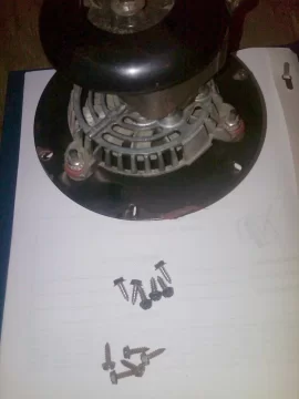

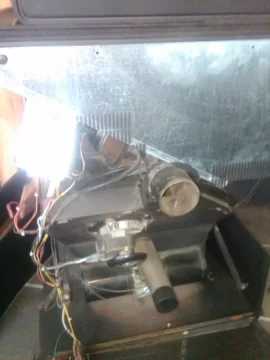

This Quadrafire Santa Fe sure has rusty mounting screws on the exhaust blower!
There are 6 very light number 8 sheet metal screws 1/2 inch long fine threads.
I picked up some heavy Stainless Steel #8 1/2 inch long with black painted heads to replace.
The threads are not as fine but they hold in well.
Also when I pulled out the room blower and saw the rusty bottom, I sanded it with emery cloth and painted Stove Bright Satin Black on the bottom. :)
  • Anyone have rusty Exhaust Blower sheet metal screws in their pellet stove?
you think its caused from condensation maybe?
Hi DirtyDave
Yes, It was used in a basement that had some dampness close to the floor for a few years.
