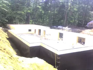

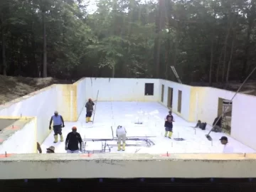

lowroadacres said:When we bought a used cedar log house to move to our acreage we weighed everything out and made the choice to go with insulated concrete forms or ICF for short.
The main reasons we went for ICF were ease of handling, increased insulation values and resale value.
Due to the fact that we did not have to rent forms or hire someone to form up the basement before the pour we did the ICF basement for less than we would have paid a contractor to construct a traditional basement. This was magnified by the fact that we did not have to strap and insulate afterwards but rather we were able to hang the drywall with relative ease. I say relative because we did one tiny thing wrong.... Somewhere along the line of stacking the blocks the instructions that I had been given from our contractor friend did not make it from me to my buddies and the "X"s" on the blocks did not line up after the first three courses of blocks. This added several hours to the drywall job as we had to map each set of anchors and measure and pencil mark each drywall sheet to be able to hang them up properly.
Needless to say the fellow doing the mudding, taping and sanding for me got a real kick out of my handiwork.
I would highly recommend the product and if we ever build again (I hope not as we still aren't completed this house) we will be using the product again.
