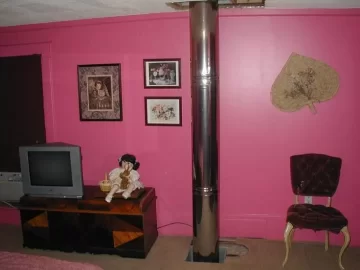

I'll throw out some information . #1 I have a two story house. Going through the first floor i boxed the floor hole for the pipe with cement board the thickness of the floor. #2 I did the same thing for the ceiling of the second floor BUT i went all the way to the roof with my box of cement board. The second floor pipe was boxed in to the from floor to ceiling . So now the ceiling/floor of the first floor has the pipe boot , from the boot to the roof of the house is open but all boxed in . What heat that is made inside that box goes all the way to the roof and then the heat goes out the top per the pipe boot on the roof . No ice dams , the heat from the chimney inside the box in space goes out the roof boot and not into the atic . Pictured below shows the pipe in the second floor before it was boxed in . You can see the floor where the ceiling/floor is boxed in with cement board . Same as the second floor celing except it goes to all the way to the roof . The bottom box has 3" clearance to the pipe and the top box has 5" clearance.

Roo, is your box insulated? your solution is kind of what I was thinking originally, but I expected it to go through non-living space.
WOW is that room PINK!!! Your S.O. wouldn't be a Mary Kay consultant would she?
About the box being insulated , we have attic insulation up to it but nothing on the inside of the box . Normally tou would have to have an attic boot , we bought the boot but wanted the boxed in area to go higher so we ended up making the box with cement board and took back the attic boot . No Mary Kay here , the room is way more PINK that it looks in the picture .
