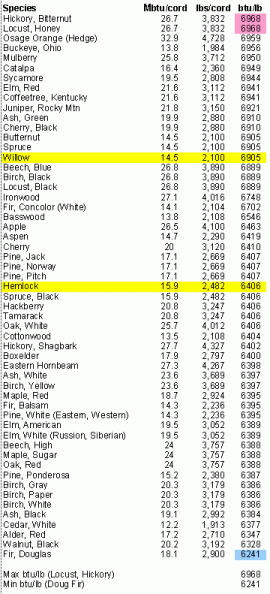

Creek-Chub said:
Per cord, sure. But not PER POUND. A cord (4x4x8) of oak weighs X. A cord of willow would weigh significantly less than "X". Both are 4x4x8 when stacked, but you'll get more heat from the Oak. 2000 pounds of Oak will still put out the exact same amount of heat as 2000 pounds of Willow. It will just be a smaller stack.
Creek-Chub, I'm not sure this is actually true. I know you might think it makes sense that all woods have the same heat output by weight, but they don't appear to in any table I've read. There is a variation of up to 15% of heat output by weight. I know this is a lot less than variation by density,as in weight per cord, when some species like Osage Orange are over twice the weight of others (eg cottonwood, cedar) but it is still a variation, and 15% is 15%, and not "the exact same amount of heat".
There are many tables available listing weight per cord and heat output per cord of many species (broken link removed to http://www.chimneysweeponline.com/howood.htm) If you divide heat output by weight then you get heat output per pound, which varies from ~6,000 to ~7,000 BTU's per pound (well in all of the tables I have seen), hence ~15% variation.

KC, I agree with you disagreeing with the previous disagreement of cozy heat, but I disagree with your reasons :)
1) I agree there are many internet quotes saying all wood is equal (pound for pound) in BTU's. Dozens of them when googling for firewood species heat output tables. However, that doesn't make them right.
2) Even the link you gave only states "approximately" equal, as you say yourself. I suggest they equate the 15% variance I alluded to as "close enough" and it might be for some people, but it's not "the exact same amount".
3) I worked through a few tables I found listing pounds per cord and MBTU's per cord and all had variance of up to 15%. I even found a table listing BTU's per pound, but frustratingly, can't find it now for an easy link. No matter, it's a simple process to divide one column by the other, or copy and paste into Excel and extrapolate, and the results are the same.
Here is one popular table, link in my sig. I did the Excel bit and added a btu/lb column. As you mention there is about a 12% spread in this table - possibly due to some of the rounding to the nearest 100,000 btu/cord. The surprising thing is - it is not necessarily the 'heavy' or 'hard woods' which have the highest btu/lb. Bitternut Hickory, Honey Locust and hedge do score near the top, but there are several light weight woods up there as well - willow comes within a couple dozen btu/lb of those woods. Oak, shagbark hickory and hornbeam all score less than willow, several pines and white fir.
