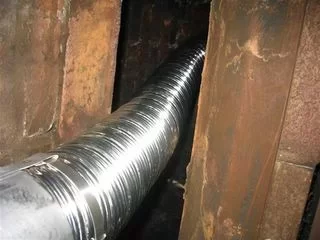

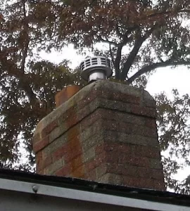

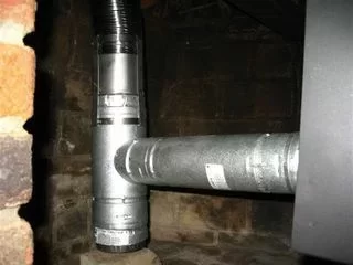

Kast, I don't have a horizontal install..
my vent goes from the stove into a
Cleanout T, then all the way up the chimney
topped with a rain cap. (see pics and see stove in avatar)
I remove the T cap, vac that out,
then run a nylon 4" brush 12ft up.
I keep the vac running directly below
the T so it catches everything that
comes down. I continue to run the
brush until nothing more falls down.
