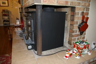

When I put my liner in last month I left the surround off and doubt it will ever go back on. I had just plain black metal with a gold trim that was a pain in the arse to put on and take off. I like the way it looks better and like some I painted the inside of the fireplace black. I did install Roxul and a block off plate and am convinced that I get much more heat with it off ass the whole back 2/3 of the stove is now in the 'living area' of the house as opposed to being close off.
Anyway, I like it better for heat and looks.

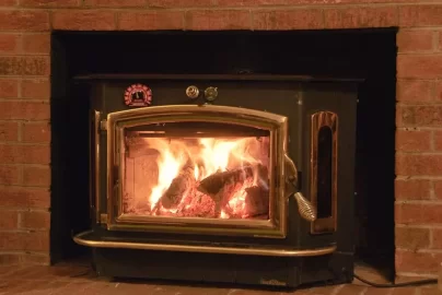

Another Buck stove here w/o surround. It likely depends on the stove design as to whether it can be done in an aesthetically pleasing manner (SWMBO actually likes it better w/o). Stoves like the Bucks are designed to be used stand alone or without legs as an insert. Because they don't have the the unfinished look of many inserts (behind the normal shroud area) they just look like a hearth mounted stove...pushed all the way into the fp.
My first choice b4 getting the Buck was the BK Princess. It just wouldn't have looked as good w/o a surround.
Note: Support post has been painted since this picture was taken.

Thats an interesting install. Did you cut out the wall of the fireplace to do that?

Thanks. No, it was constructed as a corner fireplace and was here when we bought the house in '87. Used to have gold doors that wrapped around the corner, hiding the post. It also used to have a 4" thick wooden hearth that wrapped around the fp - complete with several deep burn marks. Not the smartest decision on someone's part. That wood was used to make the mantel above the stove. I added the cantilevered row of bricks and tiles.

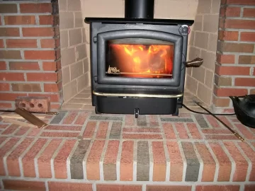

I would have it no other way. Esp during a power outage. It was out a few weks ago and we never would have known. We heated dinner and stayed just as warm as ever. Those were my main priorities when I decided on installing one up here in the living area of the house.

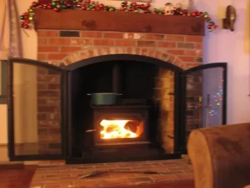

See my avatar. Jotul C550 w/out surround.
May not look quite as "neat" as using the surround panels.
Does it project more heat than with the panels ?...I can't be sure, but I do get a ton of heat into the room.
Aw heck, might as well post a pic of the new setup.
Thanks to everyone else who has shared!
