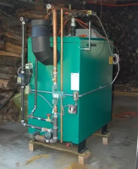

Would like to know how you guy's are getting you wires to your control box.I don't see any ports or knock outs on my eko 60.My brother had to drill and I thought that was strange
I ran a piece of Romex up alongside the power cord that comes out the back. Wired them both into a box that I attached to the back panel with sheet metal screws. Here's a pic. It's that box on the left just under the black low-water cut-off switch.
  • [Hearth.com] Any tricks for wiring eko
How did you feed your thermostat wire into the top .
You mean the connection to the house thermostat? I don't use that feature. But if I did, I'd snake it up the same path as the power cord from the controller.
If you're talking about the thermostat wire in the picture, it's hooked up to the aquastat on the return line. It runs a three-way zone valve.
I have a passel of wires running into my controller housing - sensors, relay controls, and so on. I snaked them up the side of the boiler right against the water jacket on the side opposite the line cord. I figure it won't be above about 200 degrees, and the wires can handle that.
I used the black (1" diameter) plug on the top of the jacket, it was a shorter path to snake everything.
