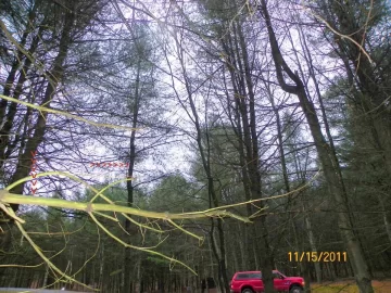

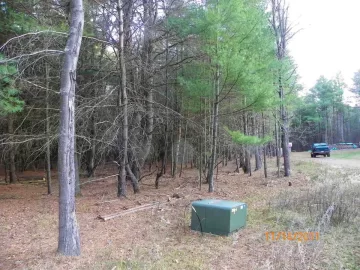

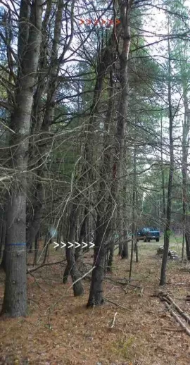

My goal is to get these three trees down safe and not hit the transformer. Picture 4241 is a rotten pine with a small dead cherry tree, in pic 4242 you can see the red arrows at the top, the cherry is resting on the dead pine so I think if I cut the pine the cherry will come with it.

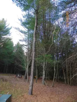

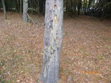

Picture 4243 is a white pine which needs to come down, looks like the natural lean goes in to the woods, pic 4244 is why it has to come down (Pileated Woodpecker).
We have cables,winches,the rhino and the old green truck for use.

White pine, pine holding cherry, drink beer.

I think the bigger pine will go last in to the woods, the cherry will be first, have the cable on it then cut it and drag it out from the backside. Then we will do the dead pine the cherry is resting on second unless the dead pine is real weak, will check that in the morning.

Is there anything you can put around or near the transformer just in case?
One old pallet, it might be time to invest in a second cable.

I don't like cutting rotten trees ya never know what will happen. But the best bet is to protect your self then the box. Since you don't have anything else to crib around it with pile firewood around it and lay some heavy planks over it.

I use a long nylon rope, Stretch it pretty tight. get a good notch & a good hinge, the nylon acts like a rubber band & pulls steady tension for quit a few feet to keep the momentum pulling the way you want it to fall.
I've topped some, climb high & tie the nylon rope. Come down a ways & cut part way thru (medium trees I use a bow saw), the pull/break the top out with the ATV.
You'll be fine. Tie off & tension it. Good notch & hinge. You've done it several times, trust your method.
Imagine it's your P/U truck parked there, you;ll miss it for sure then!

Looks like I changed my mind already, the bigger pine will come down first, I'll get a better picture in the morning from inside the woods. Just happens to be a nice lane in that area for the tree to fall towards the woods, if I can get the rhino in a safe area (not in line with the fall) with the winch and cable then the only other thing to worry about is the base. :grrr:

I was serious by the way. From the pics the White Pine looks to have an advantageous lean where you could notch it and fell it away from the box. The leaner and the leanee really don't look that big where, as Jack Straw mentioned, you could protect the box with a shield of some sort. Or you could rope from the clearing to the east. The Beer is optional.

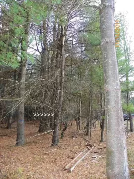

Here is the white pine from inside the woods, we have another dead pine that needs to come down that would be in it's path, you can see the dead branch in the picture.
Looks like I will use the cable with the winch and treesavers just to make sure it won't get hung up.
zap

That is the approach that I would take, Zap.

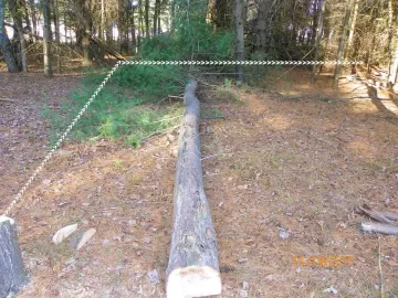

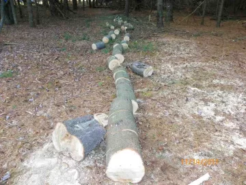

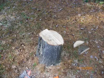

Pileated Woodpecker ruined the base of this pine so we took it down today. Put the cable around the pine (up about 10- 12 feet) then inside the woods we had a tree saver (tow strap) around a cherry tree, ran the cable through a dshackle hooked to the tree saver then hooked the cable to the end of the winch on the back of the rhino.
Once I made the notch on the font side I had my wife who was in the rhino (at a safe distance) put just a little tension on the cable, started the back cut...when it started to go the wife helped it out a bit, went better then I thought.
Limbed up the pine then took it along with some other junk wood (two trips) to the wood dump, bucked up the pine for shoulder season wood for next heating season. I would have had a picture of the setup but the card was full plus it would not let me delete pictures from the card, so after we felled it I went inside so I could grab a another card.

You've done this before :)
I like the hinge to be about 2" thick, but trees with damaged interiors are sometimes more difficult to control when you have decayed, rotten or brittle spots that you can't see.
Good job! (Well maybe 1 foot to the left would have been perfect :lol: )

The base was better than I thought. Most of the overhead branches on the pine were hanging over the backside, had the wedges ready, even with very little tension from the rhino via the cable it started to fall in to the woods right off the bat, then when my wife put more tension on, it came down to the right.
