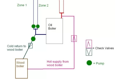

How's this?
The two zone pumps are Taco 007's, and the pump going to the wood boiler will be a Grundfos 15-58 3spd pump.

I assume the red and blue lines off the oil boiler at the top of the page come together somewhere outside the picture? If so, it looks like it should work fine given that you need to have some flow through the oil boiler for the DHW coil. I don't think you need two check valves though, I think the one on the return side of the wood boiler is all you need.
There is a slight potential for "ghost flow" through the wood boiler when it isn't running, but I think the oil boiler should be enough lower flow resistance for that not to be an issue. If it was, you might need to put a zone valve on the wood boiler line in order to force the flow through the oil boiler. (If you didn't need flow through the oil boiler, I'd be tempted to say put a ZV on the oil boiler as well, but...
The only issue I see is that you might get some odd flow patterns through the oil boiler depending on just how the flow rates of the wood and zone pumps combine and depending on which zones are running - you are doing sort of a weird form of primary secondary pumping, and depending on how the pumps combine could get flow through the boiler in either direction, which might have an impact on the DHW coil - It might be necessary to arrange the controls to cut off one or both zone pumps on a call for DHW heating if you don't get enough hot water flow through the boiler.
Gooserider
Gooserider
How's that affect the dhw coil? Also, yes, the blue and red pipes at the top go to the baseboards in my house.
If you have a better plumbing layout, please feel free to share.
joecool85 said:
Gooserider
OK - the only reason to want flow through the oil boiler at this point is because it has your DHW coil in it, so it is sort of an additional zone...
The water flow through the oil boiler (OB) is going to be a function of the difference in the flow through the two zones, and the flow through the wood boiler loop (WB).... Lets look at some cases:
1. If the zone pumps are off, all the flow goes through the OB.
2. If the flow through the zones is exactly the same as the flow through the WB, then there will be NO flow through the OB.
3. If the flow through the zones is LESS than the WB flow, then the difference will flow through the OB, going from supply to return.
4. However if the zone flow is GREATER than the WB flow, then you will see the extra return water flowing backwards through the OB where it will mix in with the supply from the WB and make a second trip through the zone loops (this will cool the water flowing through the zones as well...)
How does this affect the DHW coil?
#1 should be no problem, the coil is getting the entire output of the WB.
#2 is a definite problem, as the coil will only see whatever heat is in the boiler, so you need to kill one or both zone pumps in order to get case 1 or 3. (you might also need to look at control setups to keep the boiler from firing in this situation)
#3 is probably not a problem, depends on just what that flow is, and if it's enough to supply the DHW heat demand. Unless you have a really high demand, or the flow is real low, probably not an issue. If it is, cure is same as for #2.
#4 might be a problem depending on the temperature of that return water, and whether or not it is still hot enough to satisfy the DHW demand - again, if it is a problem, same cure as #2....
In terms of what I'd do about it for alternative piping diagrams - my first choice would be to get the DHW out of the boiler and into a 3rd zone, as I've mentioned before, and then get rid of the flow through the boiler unless it was actually firing. Given that you don't want to do that at this time, I don't see any real problems with what you have. (Which isn't to say that some of our other posters might not have other ideas and suggestions...)
Gooserider

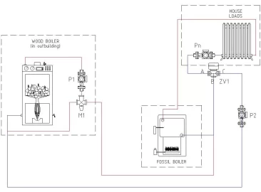

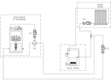

Another option might be to tie the WB in with a pair of closely spaced tees, as I did in the second picture. This hydraulically separates the WB pump (P2) from the zone pumps, (Pn) and solves the problem of pushing unwanted flow through the zones. However it brings back a variant of the earlier problem, in that the OB will not see any flow from the WB unless one or both zone pumps is running and circulating water through the house loop... Incidentally, the close space tees approach gives much the same effect as an HX, without the efficiency hit...
Gooserider
Edit - note that P1 and M1 are not critical in this drawing, they are just the return water protection, and could take many different forms, I just put them in my generic blocks as an example...

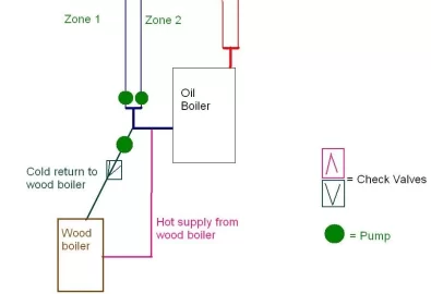

joecool85 said:
I like #2, is this modification of my drawing decent?
Yes, it's functionally the same as my #2, as long as you make sure that the actual connection point is a pair of closely spaced tees, i.e. less than 4 pipe diameters between the two tees, and at least 8 pipe diameters of straight run on each side of the pair...
