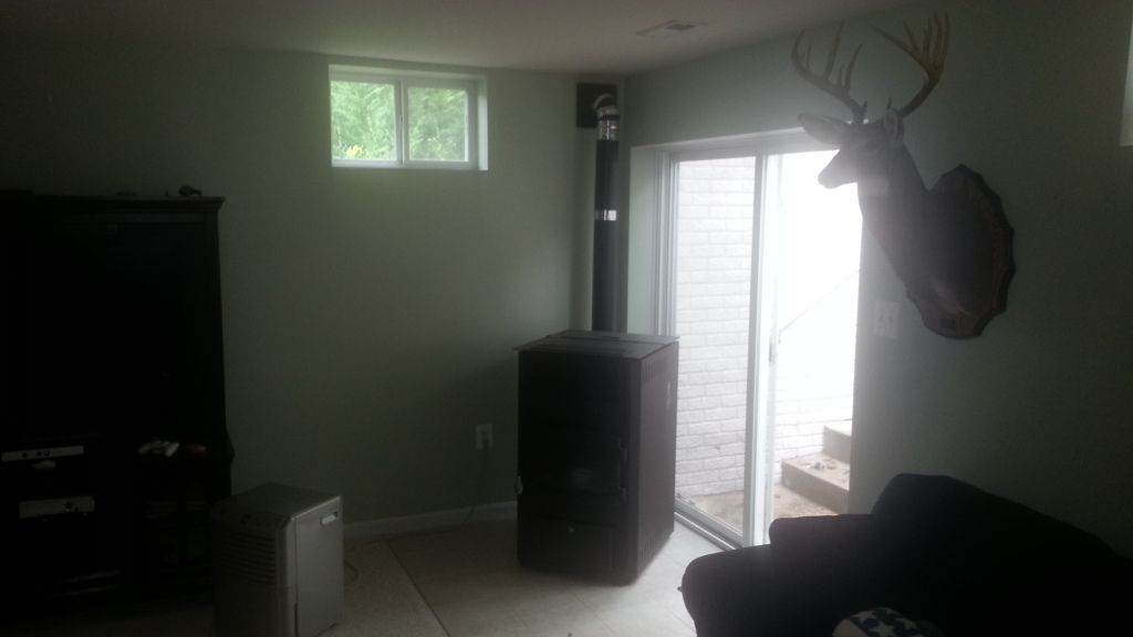

So here's my setup. There seems to be an airwash as you can see on a picture. There's a small opening below the door opening and above also. You'll also see my home made OAK. I've installed it in january that way 'cause it wouldn't be a good idea to drill a hole in the wall at this time of the year here up north. I know that having the stove sat on a wood pallet is not really up to code but this stove weight a ton or two an I'm planning to build a tile podium next spring. By the way, please do not comment on the wall color as it was painted by previous owner...
After a good cleaning, the glass gets dirty after a few hours of burn and I also noticed that there's alot of ash in the drawer... I might contact Drolet next week to see what they have to say about that. An other thing that is bugging me is when I turn the stove off, the convection blower turn to its highest speed (don't know why but I don't really care) and there's a smoke odor coming along with that hot air? I don't understand how that hot air can come in contact with smoke...
