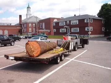

Here's how I would "tackle it". Cut it into a 4' length. Park one truck at the road edge as an "anchor point". Using two 1/2" ropes, tie the end of each rope to the stationary truck, one with a "plow frame" would be great, (trailer hitch otherwise). Run the ropes down to the log, then under and back over the top of the log. Pass the rope around a "friction free point" (pulleys would be nice) and then tie off to the second truck, then pull that truck forward...should roll right up the hill. Make a ramp onto the trailer ("pike logs"...four inch diameter oak "x" number of feet long work great for a ramp) and lever the log on, use a couple of splits as chocks...and enjoy the workout. That's how I would do it. Just keep in mind, "green-fresh cut" oak, if my memory serves me correctly (at 4:30AM), 36" diameter weighs in at roughly around 500 lbs/ft of log length. Ultimately though, I would lean towards getting a log truck to do the work.
Sounds like a lot of prep work, and the first few times are intimidating, but take it from someone that has moved some good sized logs with minimal "specialized equipment"...lol :)
