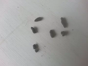

It's coming from between the roof trim and the siding. I was up on the ladder and could here it scratching as it moved. The area of the roof is 4' up from the attic floor.if it's the size of rice than it not your average mouse it has to be bigger. where did you find it? looks like the size of bat or rat.
I like bats. We watch them fly about eating mosquitoes at dusk. Should I let them stay! Or build bat houses nearby?Its bat guano. The broken bits is the givevaway. Its insect exoskeleton.
So how do I evict them, short of killing themThere are plenty of reasons to get them out of your attic. Bats are rabies vectors and 1 or 2 of the bats we have tested each year test positive. Their droppings also contain histoplasmosis. It's a fungus that, if it gets into your lungs, can prove fatal. Bat boxes generally aren't that effective in my experience. You're better off excluding them and letting them find their way into your neighbor's house.
