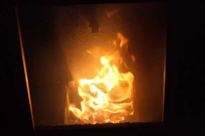

Here's a shot of the ash left after burning the stove for 5 hours today, and the flame at 5 - 5. I wouldn't describe the fire as lazy, it's practically the opposite. Looks drafty inside, wisping upwards past the point where you can see through the window. (At least on 9..)
If the stove is operating properly and this is a case of improper application, then... doh. The wood stove had the distinct advantage of being able to heat the entire house, basement (and plumbing) included.

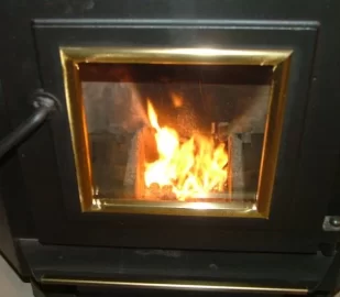

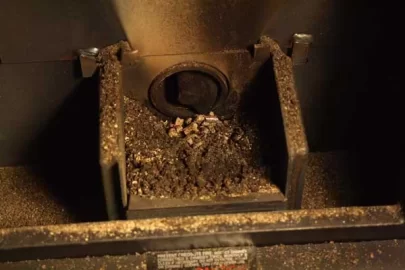

Here is a couple of photos I just took of my stove as an example and to show where I have a thermometer to monitor temps.
At the moment the stove is set to 1 for heat and 5 for the fan, the low feed to 4 and the low air to 9. The thermometer shows that it is 200*.
At this moment I am using Penningtons Nature's Heat pellests, I had to set the LF up to 4 for these. A couple weeks ago I was using Hammers Hot One's and set my LF to 3 and LA to 8 and had about a 10* increase of temp. on my thermometer. And Last week I was using Freedom Fuel by Natures Earth that I pick up at the local HD and had to set the LF to 5 and just barly getting 170* out of it and even had to put the room fan down to 4 and I seem to have more ash build up as well. So pellets and LF, LA make a big difference for my stove at the 1 setting.
Stove is in the basement about 1200 Sq FT unfinished and the cinder block acts as a huge heat sink, the ceiling is insulated between the floor joists (1st floor)
Temps at this moment is 72* basement at the other end, and upstairs living area is 68*, outside it is about 35*, the stove is on the low settings,
Don't know if this helps a whole lot but it might give you some idea what to expect and then what to expect with different pellets.
