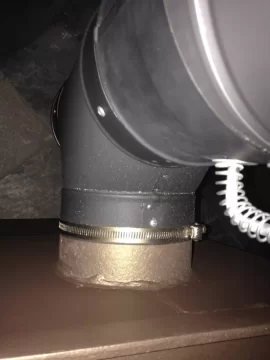

Jumbo Mo, this is what I did on my Mid Moe. I am sure you can find a stove pipe adapter somewhere or just crimp one down but, I tried it this way with the female end of T over the stoves flue and it works just fine. The older stoves I have been fiddling with this year seem to have this same deal with outlets not fitting what you get at the store.
