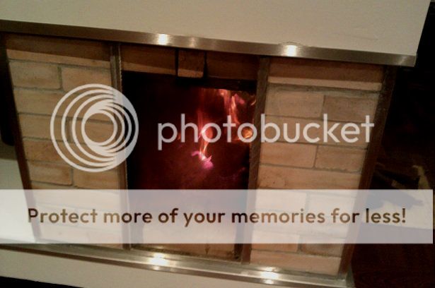

It will feature enlarged primary air openings (it required an open door ignition for a few seconds) and secondary air steel tubes for testing purpose - note the cuts on the stainless steel front plate - this is not how it will look in the end...
Here are the pictures...

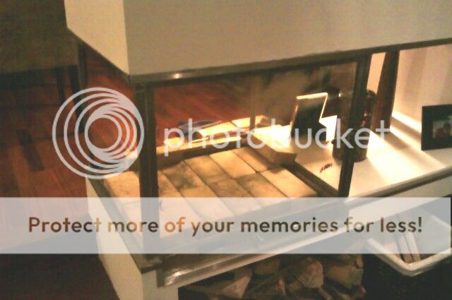

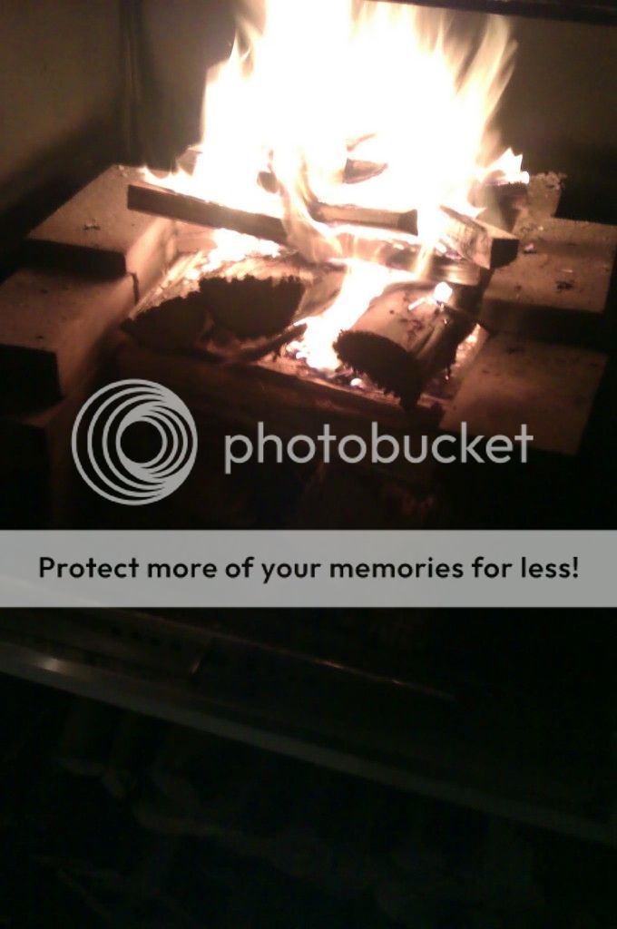

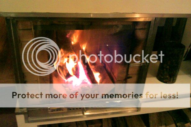

Last year's burning method with some firebricks inside (yes it's a top-down burn...):

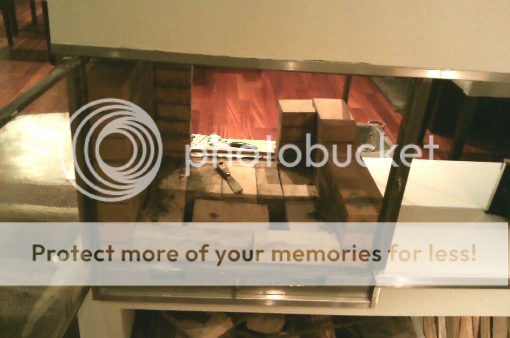

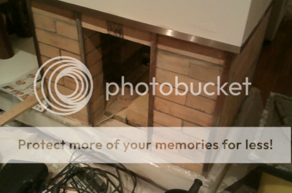

Fitting the bricks after removing side and rear glasses:

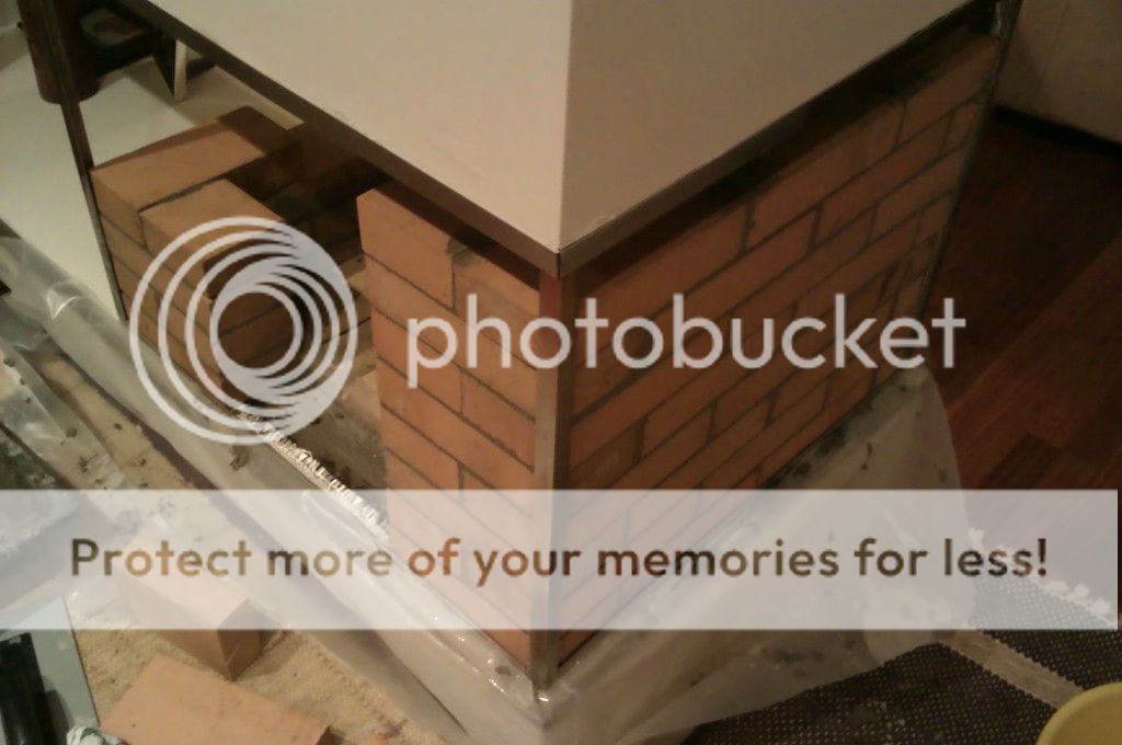

The rear side will have only 1/3 of the glass:

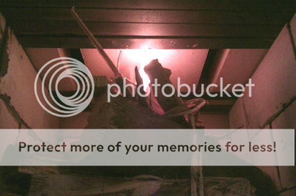

The rear side is now almost finished:
