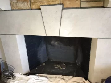

Started with interior masonry firebox 1yr old. Dimensions are 46in wide, 31in high, 24in deep, and it narrows as it goes back. I stained the firebrick black but wish now that I hadn't.

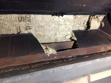

So next I cut out my damper and stuffed some Roxul up there to keep the air out.

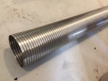

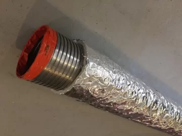

I then took my Heavy Flex line and insulated it.

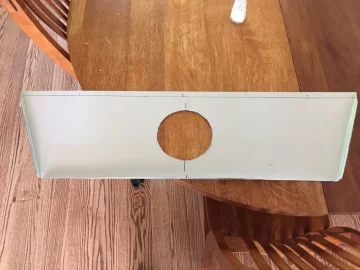

Then I lowered 22ft section into my chimney. I then fabbed a block off plate.

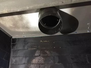

Secured the plate in the chimney and stuffed tons of Roxul in there and pulled the liner through.

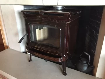

Next, place stove in firebox and attach liner.

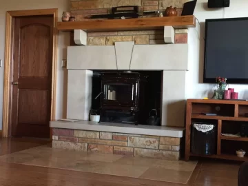

All done and very pleased with results. Please comment if you would on my proximity to the mantel. Distance is 24in. Stove sits out of firebox 8in.

I totally agree with your regret of staining the bricks black. You can see the stove fine as they are but it doesn't pop as they are similar colors. Still a great looking install. Thanks for your documentation of the process.

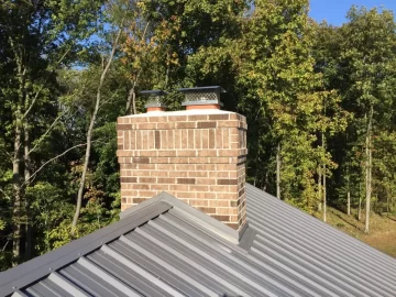

As long as you're in a working mood, why not go up there and re-pour that chimney crown, this time with a nice couple of inches overhang to protect all that pretty brick work.
Ha ha! Yes that will make the list eventually. Right now I have the crown "Duck Coated" and Chimney Saver on the brick to get me by. I don't like fans for the noise and I like the idea of not relying on electricity. I never heard any of the PE fans but I had a zero clearance once and I never cared for the noise of its fan.

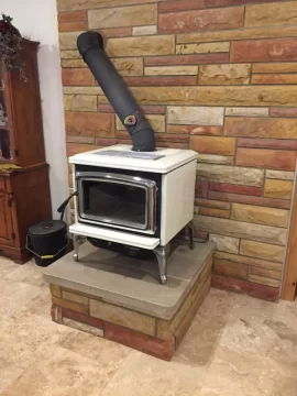

Thanks guys! I have had the Summit classic in the basement now for 1.5 seasons. The first year we used it for about 1/2 the winter while we were still building the house. It is an amazing stove. My chimney is interior and the Summit vents into a 6.5 in (ID) square clay flue. Flue is approx 30ft with another 3ft of stovepipe. It actually does very well despite no liner. I am excited to use the Alderlea T5 because it is so different from the Summit but in good ways. It is smaller and we chose that size because the upstairs is foam insulated and no masonry to suck up heat like the basement walls. I am looking forward to loading this stove before bed and then going to sleep knowing the stove is heating all night.I could not do that with the fireplace.
