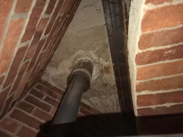

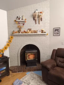

Hey all,
Looking for ideas. I currently have a pellet stove in an alcove. It was set up this way when I bought the house about a year and a half ago. I'd really like to swap it out for a wood stove. As you can see in the pictures attached, everything on the interior is brick, with a brick chimney but it's not brick all the way through to the outside wall (wood framing and siding). It looks like this was built for a wood stove originally, as it has a 6-in pipe, but my local fireplace shop says that because it's not masonry all the way through the outside wall, then none of the modern stoves can be installed in the space as is. There's just not enough clearance between the back corners of the stove and the walls, and of course there's vertical clearance to consider as well. Basically, this alcove was built in the late '80s and may have been to code for a wood stove then, but not anymore. According to the shop, I would basically have to demo the whole structure to make a freestanding stove work. The other option is to modify the current opening to accommodate a zero clearance wood burning fireplace. I've included a couple of pictures, the one that looks weird is the inside of the alcove. The cement barrier you see inside the alcove is approximately halfway up the wall, I don't know what's above it as you get closer to the chimney. I know I could just keep the pellet stove, but I'm looking for the best path if I did decide to make the switch .
My main questions for this forum are:
1. Would you recommend modifying the alcove for a zero clearance wood burning fireplace or demoing the alcove and rebuilding something else to accommodate a freestanding stove? My main concern is that type of stove not heating as well, but it would be cheaper and way less of a headache than rebuilding the whole thing.
2. If I demo the alcove, what am I really getting into? What am I likely to find in the space I can't see? In particular, is the brick chimney likely structurally dependent on the brick alcove? I can't really see how it wouldn't be, and the part I worry the most about with taking the whole thing apart is having to demo the chimney too. I'm not familiar with how these are constructed considering the masonry alcove and chimney with wood framed wall and siding on the outside.
3. Any alternative ideas?
