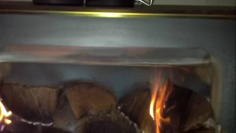

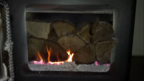

When you open your door, is there a slit or channel you can see at the top?? (Door open).
On an Englander its very visible..
You can see my 1st secondary tube, then there is a channel for air, then the top of the door.
Other pic you can see it a little better. This is the Primary air. It comes through that slit/channel and "washes" down the glass.

Closing the door should have been really interesting. :roll:
WOW!!!!! That does look like there sticking out. But I opened the door to take the pics. They are about 1" back from the front channel at the bottom.
They are dead even with the splits beneath them.. Does look odd in the pic?
But door closed fine. Weird. The cutout is even with the curve and radius of the upper right hand split. Makes it look funny.
Optical illusion and very old eyes. :lol:
