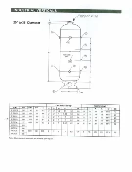

I used new air tanks in my system for several reasons. The are new so no work cleaning out propane tanks, or worry about rust pin holes, or other damage.
The tanks are vertical which stratifies better, and they already have a base. There are many threaded ports on the tank including on the bottom which I plumbed for drainage,
so no cutting and welding in ports. The tanks I got are rated for 200 psi, so no worries there. And the shape/size worked better for my application.
Here's a cut sheet on the tanks I used.

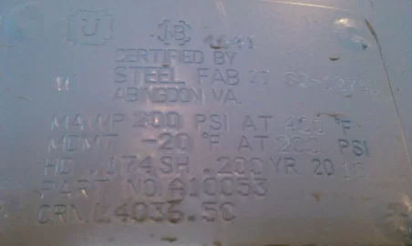

Here's a picture of the plate on the tanks. I found that only a few manufacturers names were being mentioned by the various suppliers I spoke to, so it seems that the quality and workmanship in tanks is pretty similar from supplier to supplier, because they are basically re-selling tanks from a company that just fabricates.
