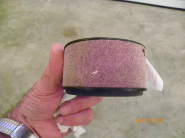

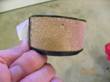

The filter from the 660 which I used on the beech.

Thats it the outer part is a pre-filter and comes off easy if you want to really clean it...Best to just blow it out with compressor! Thagts a hd filter used on 460,660,880.

I knock mine out on my pant leg every 2-3 hours of operation. Easy preventative maintenance!

yea if your milling every singal tank of gas.....Biggest killer on milling saw's!
Zap that is the same as the MS440 too... Like Jay said, clean it off with the air. I'm fairly gentle though and I try not to aim directly at the filter. Come at it from an angle so the dust goes off to the side...

I go inside out as well and take the pre-filer off once in awhile to. Milling you better do it more offten than not.
On the main filter body I do go from the inside out. The strechy fabric thing too but usually it is not too dirty....

Yea the per-filter works very well. Milling the dust can get very fine though. Cross cut knocking it on something works very well because the dust is much bigger particle's, but darn sure dose not hurt to keep it very clean either way!

When blowing out a filter blow it out from the inside otherwise you are driving particles through it.
