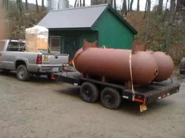

oooooooooooo.... I love the looks of those tanks on their website. Nice refurbished and yellow and all set up. Does anyone have any more info on these? Has anyone any bought anything from this business? I am determined to have pressurized storage all set up before April. I have a plumber ready to go... just need tanks! I know i should just call..... but... does anyone know how much AHONA charges for the 2 500 gallon tanks ( yellow ones in pic). ?

Purchased a 500 gallon tank from AHONA for 700 dollars 2 years ago. All welded and ready to go. Did a little extra cleaning, and it was ready to go.

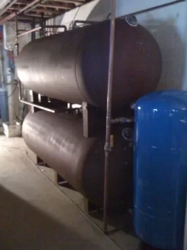

I have two AHONA tanks with 4" ports and 2" ports added, plus the saddle package for vertical mounting. I don't weld and Mark and Nate at AHONA do this for a living, so I paid them for their services. Tanks were 1300 each last fall plus fittings. I also go the boiler from them. I wished I had cleaned them with bleach before putting them in the basement but oh well...

Thanks for the info guys! I really like the look of the tanks.. and how they are set up. I rreally like how they come all set and ready to go. Did someone say I would still have to clean them out? This i do not like. I would love it if they came all set and 100 percent ready for my plumber.

I happen to be the proud owner of those yellow tanks in AHONA picture. Those are out in my boiler shed along with a Paxo 60. I then feed a 620 gallon stss tank in the basement too.. I have one fire a day, a load or a load and a quarter of wood and can go about 15 hours on heat before I'm down to about 135-140 dgrees. At times I've gone 24 hours, when it's been like 38 dergees out. I have all radiant heat in a 1500 sq ft Log home , plus a 38x40 garage with radiant heat. I can get useable heat even when the STSS tank is down to 125 degrees. Had to put in a controller to shut the STSS tank down once it reaches 165, as the tanks in the shed are 180-185 at times. First year with the Paxo, so it's been a big learning curve. Woods 20% so I had to run my flue gas a little hotter than normal. Sure beats my outdoor wood boiler I ran for 7 years. Mark at AHONA is a very smart guy, thinks way outside the book, and has answered his phone , every time I've called, with any questions. He designed my whole system and been excellent. He's there 200% after the sale. I'm really happy with my set up. As posted before on the hearth, a big investment, but nice not being tied down to the stove anymore. Kind of burn when it's convenient. I always seem to have heat...Charlie

xclimber. yes i could do 2800. sounds ok. however.... i know very little about stting these tanks up. Will i have to get some sort of copper tubes to put in the tanks? can you describe the steps in setting up your tanks?
Birdman,
The copper pipe is used to connect your boiler to the tanks, or you could use black iron also. There are schematics on here, simplist pressurized storage system design, listed at the top of the boiler room site. Or you can even call Mark at AHONA. He could give you a good heads up on other possible layouts, and also maybe other people on this site will chime in. There's alot of smart people on here, as you will see as you start to log on more. Mark's tanks also have a 4 inch port to except a solar hot water coil, if you decided to add that on ,later.
