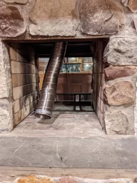

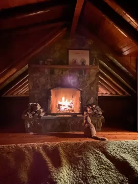

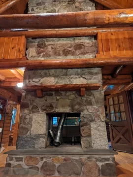

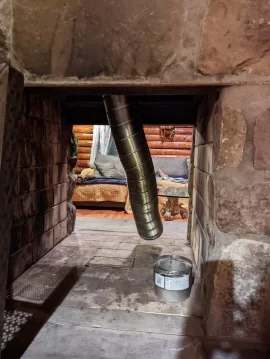

I was wondering if anyone had ideas how I could hide or conceal exposed chimney liner?
Let me explain. I have a double sided open fireplace. Since moving into my home last fall there has been an older free standing woodstove sitting inside the opening so it was flush with one side of the firebox. The stove was connected to a black flex pipe/liner that went 1/2 way up the masonry chimney. At the top of the firebox a steel plate was fixed to the chimney with an opening cut for the liner to go up through.
After repairing the roof and chimney we have purchased a new EPA certified wood stove. The dealer recommended a new chimney liner as well. I agreed. We have ripped out the old stove and installed the new liner. I plan on having a new steel plate fabricated and reinserted at the top of the firebox.
Per the installer the plan is to connect the liner directly to woodstove. However I'll be stuck looking at the ugly chimney liner on back side of the wood stove.
The installer suggested spray painting the liner which I felt was more of a last resort. I was wondering if I could hide the liner inside black chimney pipe? I figure I could run it from the steel plate to the back of the woodstove.
Any suggestions are appreciated. Attached a couple pictures not sure if I'm explaining it correctly.
