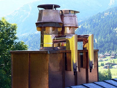

Maybe he can look into cleaning up the exhaust, an (ESP) electrostatic precipitator would be a good fit for that.
