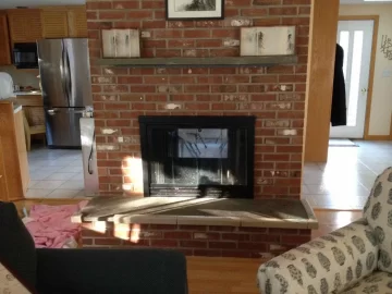

INSERT IN DOUBLE-SIDED FIREPLACE? The several stores I’ve stopped in seem fine to install in a double-sided fireplace; one site I saw declard that no pellet inserts are currently approved for doublesided fireplaces. Any thoughts on that? I’ll include a picture of one side in case this matters; both sides have the same glass doors that pull tight to seal the opening and a black mess screen that can be pulled across the length of the opening just behind the doors. In the photo, you can see chairs' legs at my kitchen table while looking through the fireplace. The double-sided fireplace opening that won't have an insert faces the table where we eat.

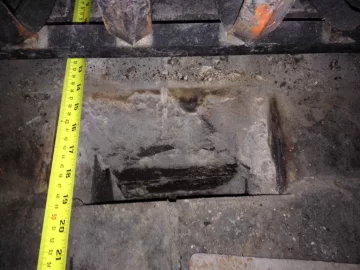

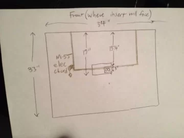

I don’t think it is an option to have an outlet flush w/ the floor facing up….in other words, I don’t think we can put the outlet box itself in the highest part of the ash chute. The insert will take be 16 and 1/8” deep, this means that about an inch of the outlet would be covered by the insert. [See my not-to-scale diagram, showing the possible placement of an outlet partially covered by insert, and attached pic of ash chute on the fireplace floor; ignore the black grate which would hold logs. Though the chute ends 19” back from the front of the firebox, some rough cement will prevent an electrical line and then outlet box from coming straight up the back edge of the chute].
